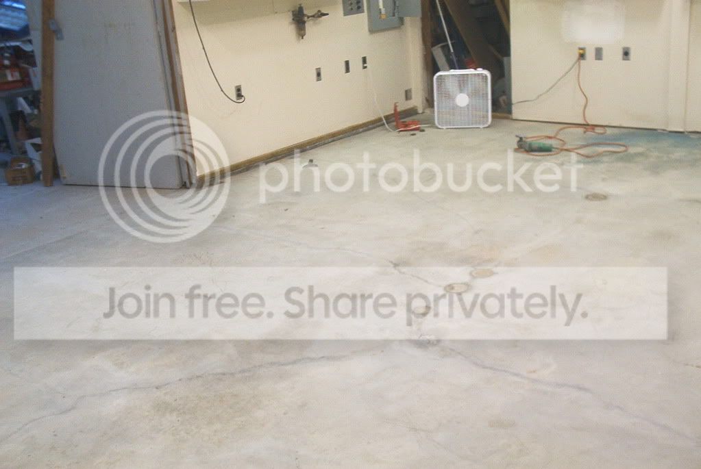

Norcal
Mar 16, 2008
13,796
Not a good option in existing shops because of cost of saw cutting concrete & removal, then restoring it, but floor boxes do work.
Taken some years back when the floor was being prepped for epoxy, a couple of 120V and a 240V receptacles.
