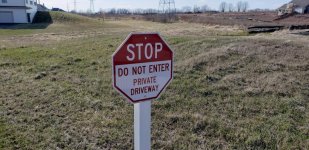

My neighbor and I also had the same problem. I put this up and we haven't had anyone come up the driveway in months.
