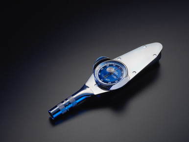

Hi all,
Snap On has recently discontinued selling Torq-o-meter dial-type torque wrenches, and wouldn't you know it...I now have a need for one. I'm looking for a USA made high quality tool. The PI dial type torque wrenches look suspiciously like the Snap On ones; I assume that's who made them?
In any case, there doesn't seem to be a lot of places to buy these. Some that come up in a google search are a bit...sketchy. Zoro/Grainger doesnt stock the part number I want (D1F50HMP) (10-50in lbs, memory) and neither do any of the other big names we're all familiar with. PI sells it directly, for about $100 more than the ones that came up in the search, so I will likely go with that unless anyone has a better idea?
Or should I be looking at a different tool altogether? I checked CDI and didn't see anything that fit:
New
10-50 in lbs, both directions
USA made
"memory" needle
at least 2% accuracy
All suggestions welcome. Thanks!

Cool. I recently bought a split beam from Precision Instruments and it’s very nice. Turns out they make them 30 minutes from my house .. never knew! Enjoy your torque wrench and share a photo or two once you get it, if you don’t mind :cool:
Zimbo
Mar 1, 2016
46
Western Australia
Just go with the PI, you can get it direct from them off their website.
I have a fair number of their Torque wrenches and they pass calibration every year without fail.

Precision Instruments does in fact make/made the Snap On Torque O Meters
I have a SO in 1/2" 0-250ft/lbs and a 3/8" 0-150 In/lbs. I did not have a case for either of mine. I got them from PI since they cost a lot less than going through SO. The folks at PI are really nice to deal with. These dial torque wrenches are +/- 2% in either direction.
I'd go PI, you could always go used for a SO. If you do go with a dial, make sure to get a follow up pointer.

Thank you. I ordered it direct from PI this afternoon. 10-50 in lbs, with follow/memory needle, 1% accuracy, with a certificate.
The used market was pretty limited and by the time I paid for it, plus shipping, plus calibration, I'd be roughly at the price of a new one.
