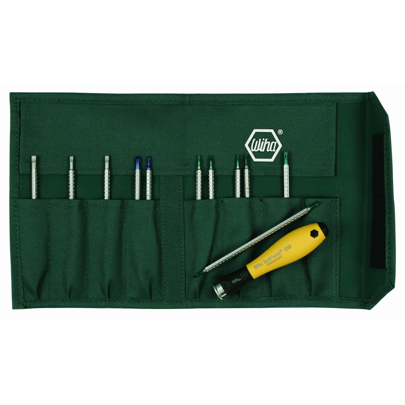

The Wiha System 4 shanks are smooth-sided hexagon shapes, but the "drive loc" versions have a series of recessed spherical depressions into which a ball on the handle lock slides, locking them into place, like the ball on a socket/ratchet set (they have this shank/handle design for larger drivers, too, called System VI, which has gotten good marks on the forum). Looks neat, but I haven't tried them. The system 4 hexagonal shanks for the drive loc versions seem to fit in the older type of handle (but they won't lock) (and the locking handle won't work on the older smooth shanks).
One important thing to keep in mind with any of the interchangeable models is that the diameter of the driver shank is larger than it needs to be for the tip size, because the shanks all have a standard hexagonal shape in order to fit into the handle. The fixed-blade drivers usually have smaller diameter shank as the tip goes down in size. This is of critical importance many times, where the screw is recessed deeply and you need a reduced shank on the driver to get to the screw head. For example, many cross-point or Phillips screws have a larger recess than the screw diameter would call for, and the screw is deeply recessed when fitted. That's one reason I have the Moody/Commando drivers, because they have a great reduced-shank Phillips driver. I found I could not use Wera or Wiha drivers for many applications because the shank was sized proportionally to the tip, and the shank wouldn't fit into a deep well to access the screw head.
If I had to start out with miniature screwdrivers, however, then I'd consider the a set of the locking shank drivers. But keep in mind that Wiha distribution in the US to retailers is apparently less than ideal, although you can order directly from the distributor's website.
Here's a picture from Amazon:
