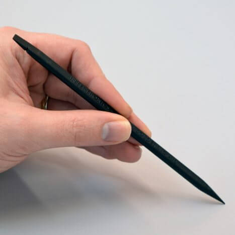

For prying, assuming you mean for opening plastic cases on tablets, notebooks etc I mostly use a solder aid. They wear and snap but they are easy to whittle back into shape.
