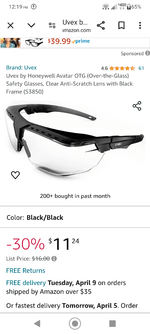

A quick search turned up these UVEX from Amazon. I've worn UVEX brand before, decent safety glasses.

@NUTTSGT Glasses to go over my glasses ****. They are super frame dependent and will not work for everyone. If I don't have my prescription safeties I would rather just go blind for the day and wear regular safety glasses.
