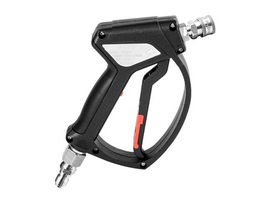

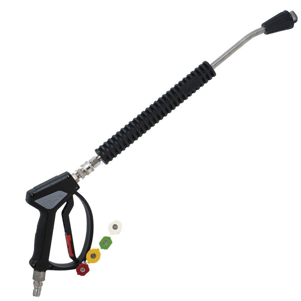

I mainly use a Mosmatic with the integrated swivel within the gun, but I also have a MTM SGS 28 which has an external swivel, like what was linked earlier by Steizer.
Mosmatic on the left, MTM on the right.................
Integrated swivel on the left (Mosmatic), external swivel on the right (MTM)..................
The wand attachment is perfectly secure, and can be used single or dual handed. My pressure washer is a Kranzle KHD-10 that does 2.65 GPM and about 1400 psi for car washing, so it has some kick to it but nothing like a gas powered machine.
Have a look through this website, you can size the wand to your requirements. A lot of the wands/lances there need fittings attached, but I can help you with that too. They do have a couple of pre-fitted wands, but they are the shorter bent type for car washing.
MTM Guns, you want the SGS 28 in particular -

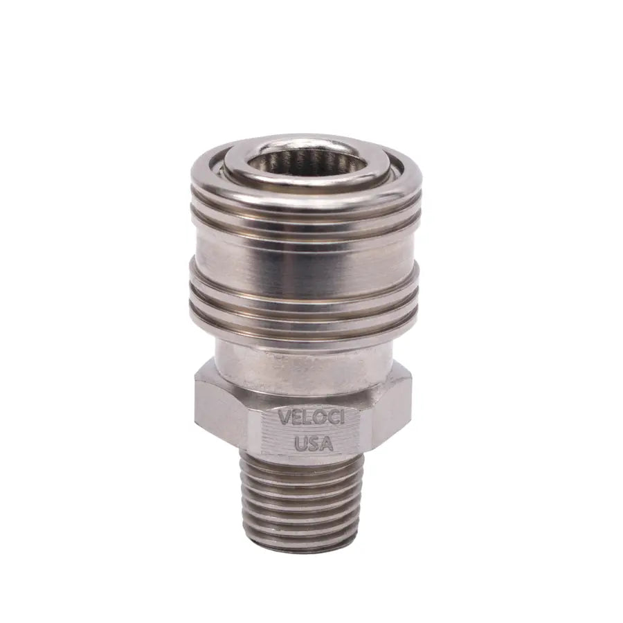

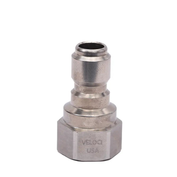

From experience, you would ideally stick within the Mosmatic ecosystem, I've found Mosmatic on Mosmatic to work better than Mosmatic on MTM. That said, it can be done, just depends on what your gun is.
The inlet to the wand requires a 1/4 female thread plug, the outlet according to your info is male threaded, a 1/4 inch quick connect.
MTM Parts PRIMA -
MTM Standard -
Mosmatic Parts -

Thank You for your reply. The gun I have is the Sutter ST2605 with an MTM QC at the nozzle, and this is where I would need the plug on the Mosmatic to connect to. Here is the tag on the Mosmatic that shows the specs. The wand outlet appears to have both an inner and an outer thread, I had to check closely because it comes with a rubber cover .

If you're running a shorty gun and want to have longer lances for cleaning the house, I'd skip the quick connects and go with KEW connectors. Much better system and way more secure. With quick connects the lance will wobble a bit.

On a shorty you can remove the 1/4 inch quick connect and screw a lance into the gun, but changing lances would be a pain. If you'll never change the lance then go that route. For those that are going back and forth between different length lances (or using it shorty-style) the KEW connectors are the way to go.
If you click on the link I provided, it explains the benefits and how it is different than quick connects.
