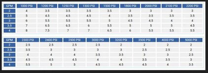

A related question on nozzles used, do you generally use the orifice size that matches the maximum flow rate and pressure of your machine or adjust the choice of orifice to match the pressure needed (less than maximum pump capacity)?

You match the orifice size to your pressure washer's max pressure and GPM spec. There are charts online that show the correct orifice size based on your specs. I attached one I found to ths post. In general, most decent capability homeowner sized machines will use a size 3 orifice, more commercial higher capacity machines often use a size 4 orifice. My personal use machine is a 7HP 3,000psi 2.6GPM unit, so I use 3.0 orifice sized tips.

Part of the question is in mind is whether users adjust the nozzle choice for orifice going into the chart at a lower actual user pressure than maximum rating for the specific machine.
For example, my machine is rated at 2000 psi and 3.2 gpm. To avoid interpolation say it's 3 gpm so the spec'd orifice in the chart is 4.5.
(The pressure washer actually came with 5.0 when new)
But if I just typically use 1200 psi and going to the chart with that the chart specs an orifice of 5.5.
Or is that not an appropriate way to use the chart?

I think I see what you're asking. The most important spec related to orifice sizing is the GPM spec, because the GPM capability of your pump is pretty firmly fixed, no matter what the output pressure ends up being as long as the orifice you are using is the proper size recommended for your machine or larger. Yes, if you move up to a 5.5 orifice tip, you would keep your hypothetical 3.0GPM flow rate and your output pressure would drop to 1,200psi. You would just be reducing your machine's overall capability by doing that though, because you will have the same GPM flow rate you originally had, but the water will be coming out the tip with less force (pressure) than it would be if you were using a smaller 4.5 orifice tip. You would essentially be making your pressure washer operate as if it was a smaller less-capable unit. Your pressure washer is able to do the most work per hour of run time when the orifice is sized based on the max pressure and GPM spec together, which would be a 4.5 size orifice in your example.
Is there a specific reason why you want your output pressure to be 1200psi instead of 2000?

The only reason I was looking into it is to see of there was any advantage setting up for the lesser pressure.
I only use mine to clean white cedar shingles and occasionally the vehicles and keep the pressure down there.
I guess there is no reason to buck the standard for sizing based on full capacity of the pump but I appreciate the information that flow rate is where to focus interest.
