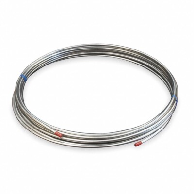

If you can justify the cost of it, you can use 3/8" or 1/2" stainless tubing with compression fittings.
This roll of 50' is rated for 2,380 PSI at 72 degrees, 3/8 stainless tubing ID is large enough that there should be minimal pressure drop at the end of the run. Most pressure washer hose is 1/4" ID
After typing all of this, would just be easier and much cheaper to get a 3/8" 50' pressure washer hose and use insulated straps to attach it to wall/ceiling and run across the garage area.
