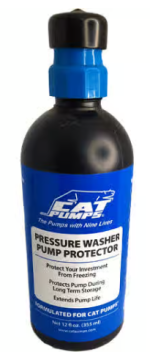

I have a Harbor Freight gas pressure washer at the shop and an electric pressure washer at home. My gas powered unit gets started and hooked up to water every 90 days. It starts easily, but it usually takes a minute or two of running before it starts pressurizing water and actually operating, so I think the pump internals are rusty.
Does anyone use pressure washer pump protector? If so, does that seem to help?

I have two gas, and one electric pressure washer. Both the gas units are Honda GX engines with CAT pumps. These get used 2-4 times a year each and I've used CAT pump protectors on them with no issues for the last 3 years (since about mid-2023):
The electric one is a Karcher light duty unit I use for small items around the house for the last 2-years. For that, I just spray in the water inlet with this stuff:
Bottom line is that all these "pump savers" use a common chemical base...propylene glycol. You want that because these pumps need a lubricant and anti-freeze post use.
Whatever you decide, spray it with something, even WD40, when your done using it and let the pump drain before you do. It will help save the pump guts. Many, many pump failures are due to incorrect post usage storage practices (lack of care / climate) along with hard water.

I do as well. Every time I'm done with it. Squirt some in and pull the cord a few times and add another squirt.
The last one I bought was STA-BIL pump protector.
Also unless yours has an external bypass never let it run more than a minute or two without the trigger being pulled. The recirculating water gets hot and is very hard on the pump.

Yes. I use RV antifreeze, pumped in with a drill operated pump.
Just pulling the cord or turning the bottle upside down won't clear the water from the pressure washer plumbing on mine.
I don't use the pressure washer often, so it gets the treatment after each use.
Have read that drying water in the pump leaves mineral deposits that ruin the seals.

I use some after every use, since I don't know when the next use will be.
Lubes the pump somewhat, displaces residual water somewhat, and adds some freeze protection.
Squirt some in until it comes out of the output hose connection of the pump (high pressure hose disconnected from the pump and gravity drained, if I'm feeling ambitious I'll run a blow gun with the rubber cone tip and the air hose from the air compressor to really blow out any residual water from the high pressure hose), pull the starting cord to turn the gas engine over a turn or two, add another squirt so some more protector fluid comes out of the output hose connection of the pump. Done.
The gun/Lance is also disconnected and drained before storage, spray tips disconnected too. Blow gun and some compressed air through the gun/Lance too before storage, amazing how much water comes out of the Lance and HP hose even after gravity draining for a while.

I’ve rebuilt hundreds of pressure washer pumps. Do this and they will not fail unless it’s a mechanical issue: after every use, kill the ignition and pull the rip cord a few times to displace as much water as possible. Screw on the aerosol can of pump saver and depress button until remaining water is out and you see foam coming out. One can of pump saver lasts years. Store pressure washer until it’s needed next. When you do this, you are displacing water and conditioning the seals. If water remains in the pump for a decent amount of time, as it dries up, the minerals are left behind and can eat away at the pump seals. Have you ever seen a pressure washer hose “chatter” on the ground while using it? Pump damage. Use the pump saver and the pump can last indefinitely.
