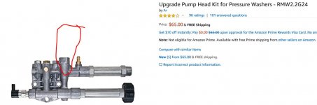

Now my only problem left is installing the pump. Some of the reviews like the one below mention an unload valve and I have no idea what that is.
My head number was 92840020. It does take seconds to swap out but there is one tricky part around the Unload Valve. Since there are no directions it took me a bit to figure this out and then had to come back and notice one comment on an earlier review. When moving the Unload Valve from the broken head to the new one you need to get the valve seat out of the broken head also. The new head does not come with the valve seat in it. Mine was a copper/brass color down inside my broken head. Two tricks to getting this out: 1-the valve seat is threaded so if you find the correct bolt to thread in just pull it out that way, 2-(this is the way I did it) took a cutting wheel on my grinder and cut off the tube that has the seat in it so I could pound it out with a punch, actually worked great you just need to cut it off to get at it from the other side. Once seat is out, tap it into the new head and insert your Unload Valve.

An unloader valve is a knob/valve assembly that asjusts the pressure of the spray. Most "consumer" grade machines don't have one.
If you've got a sub-3000 PSI Troy-Bilt/Briggs & Stratton machine, it very likely doesn't have one.
Here's a variety of them for visual reference:
https://www.amazon.com/s?k=unloader+valve&i=lawngarden&ref=nb_sb_noss_2
My Troy-Bilt 3000 PSI / 2.7 GPM did not have one.

How does it unload when the trigger is let off? A bypass actually allows the pressure to be adjusted, not all hi end ones have adjustable pressure. I am not familiar with all the small consumer level washers.

There's some kind of internal bypass, is my understanding - I replaced the pump on my Troy-Bilt before giving it to my dad, and I just had to pop the three bolts from the pump to the motor, pull the pump off the drive shaft, and fit the new pump, bolt back up.
No unloader to swap.

It must be internal. Got to have a way to unload it when the trigger is off, it would deadhead and blow up if it didn't. On hot models need to add a no flow to it to turn the burner off too.

X1 Mike: I would inspect the new pump, compare it to the old, and ensure there's nothing on the old pump that isn't on the new pump.
I've replaced the pumps on two pressure washers now - my dad's original one that the pump blew out when I was using it, and most recently, the Troy-Bilt I spoke of, which I gave to him when my new pressure washer showed up.
Both of those, it was just a direct swap - the new pump assemblies were identical to the old, and there was nothing that I had to swap. The integral unloader or bypass was something the new pumps had in them already.

ALL pressure washer pumps have an unloader. Some are fixed pressure and some are adjustable. A pump with no unloader has 2 options when the trigger is released. It either chokes the engine down or the pump blows apart. Just depends on which is stronger.
The one Mike linked says in the description that it does not include the unloader, but that they do have the same available with the unloader included. Mike will have to swap his over to the new pump like the comment in the review he posted.

I attached 2 pictures the first was the one I bought and the second is what it actually looks like. It did actually come with that valve and I didn't have to swap anything over.
All of my quick disconnects worked great when I tested it, no leaks anywhere and after I did some test spraying I set up my timer to see how long it took me to put away. To shut the water off, disconnect the supply water, empty the wand out, turn off compressor, put spray nozzle on garden hose, roll up hose, clean and roll up pressure washer hose, disassemble wand and put spray nozzle in handle, and roll pressure washer back into garage and shut door took me less than 6 minutes. I wasn't rushing just moving methodically so I'm pretty happy. If it's easier to use naturally I'll use it more.

This is true only for gas powered pumps. Many electric pumps simply shut down the motor based on a pressure switch.
True. I was thinking of gas engine washers. We've got a heated one at our shop that has an oil burner and a electric motor belt driven pump, and it cycles the motor on and off when you pull or release the trigger. Cycles the oil burner along with the pump, else it would become a steam cleaner within a few seconds :D
