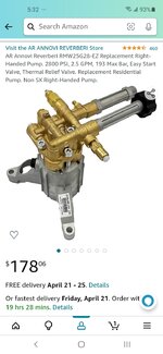

Engines generally aren't the issue on pressure washers, pumps are.
My PW is cobbled pile of parts with Honda engine and I bought a good quality pump to complete it. Pump has a brass head.
Granted it cost $128 5yrs ago, but going strong.
