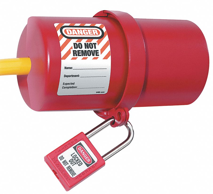

Lockout plug. Give keys to authorized users.
