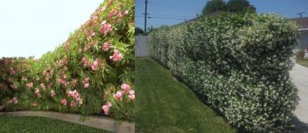

One word: Oleander. Anyone who's driven on the highways of California and seen those tall, thick enormous bushes with the pink, red or white flowers knows what a good barrier they make. If they can grow in the median between highway lanes they can grow anywhere. Plus they grow several feet a year. I planted a few as a privacy barrier last year and they are growing in nicely.
Hey - you said you wanted more options!
