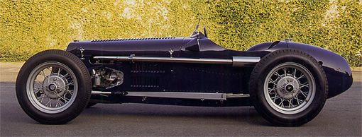

so years ago I fell in love with the "Specials" from the `30 (usually lightened and streamlined production cars ... the original hot rod idea)
intended as a Daily driver/grocery getter/ canyon carver it has to fit in the back of the toyhauler and needs to be reasonably light and compact
my earlier plan was a Bike engine (GSXR or similar) single seater along the lines of this 1930 Austin 7 Special ;
but finding lightweight drivetrain parts turned into a major problem... and the lack of torque (for moving the extra weight) as well as the high strung engine noise just didn't feel to go well with the look.

... surfing for ideas I found this pic that kinda reflects the Roadsters intend and purpose ;) ;

another pic that I use for inspiration ... ;
