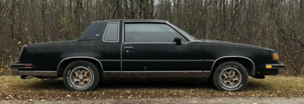

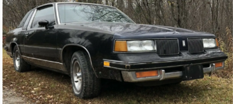

I came across an ad of someone about a hour from here looking to sell a 1987 Olds Cutlass and from the looks of the photos, it appeared to be in pretty good shape. And pretty reasonably priced too. Now for a lot of people, these G-body cars aren't necessarily considered muscle cars with their 170 hp 305s etc. But they are pretty much the last of the v8 RWD cars. And for me, the first real car I had back in university was a 1986 Cutlass - so there's quite a bit of nostalgia for me with that particular car. So I hooked up the trailer and headed over to take a lot. Given the distance, I'd rather drag the trailer there and back empty rather than have to make two trips. And if the car was in as good of shape as it looked in the picture, it was going to be well worth the price.
Got on site to check out the car. Guy selling it was pretty decent, if not a bit strange. He had originally bought the car to fix up for his daughter but had never really got around to it. And apparently his daughter was not all that interested in that particular car anyway. So the car had sat in indoor storage for a number of years, but apparently "fired right up" when they went to load it on a truck to bring it to his place etc. So I checked out the car, and it wasn't without its faults - or red flags:
- No ownership - no a huge deal around here. It's a bit of extra paperwork but not too bad overall.
- No keys - lost apparently. So ignition cylinder was busted out and the trunk lock had been popped as well.
- No battery and the battery cables had been cut. I didn't particularly care about the 305 so wasn't overly concerned whether or not it ran
- Some rust showing at the rear drivers fender (and some attempted repair)plus some staining just below the rear opera window. Probably some water ingress through the landau top
Someone had at some point taken steps to mod it a bit. Headers and dual exhaust. a "POLAND" banner across the back, some nice blue Moroso spark plug wires. So somebody enjoyed the car, but didn't seem like anything major had been done to it. Crawled under it best I could to get a look at the floor boards and rear frame rails (which are problematic on these cars). Frame rails looked fine and the floors appeared solid
The below pictures are from the original ad. you can see some of the issues I'm talking about right away. But the price was good. $1000 - Canadian. So despite some of the red flags, I paid the gentleman, loaded it up on the trailer and was on my way.
