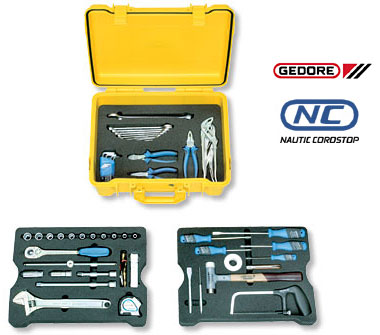

right tools for the job.... :)
www.gedoretools.com
BrokewrenchLS1
Jul 10, 2011
1,650
WV
www.gedoretools.com
That'd work great until the coating got scratched through - and then ****, ball of rust. All it takes is very little salt water infiltration below the coating, and it'll wick under the intact coating through capillary action. We see it all the time here at work during salt spray/fog tests.
The best method I can think of would be a clear lacquer on as much of the tool as possible; but, that falls susceptible to the same problem as the Gedore stuff - a corrosion-resistant coating only works as long as it stays intact. It gets even harder on things that move, like pliers - even if you coat the joints, simply by using the tool you're eventually going to wear through that coating.
