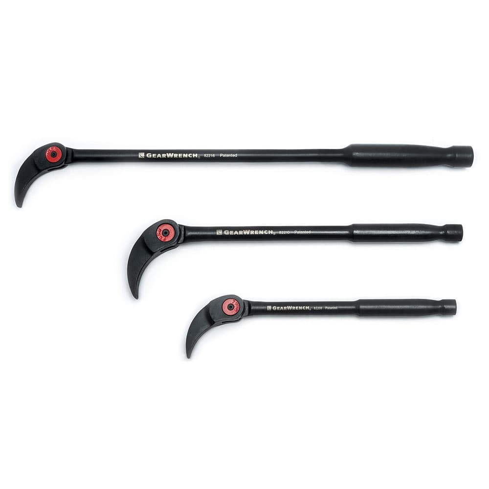

I find these indexable pry bars to be fantastic. I have 1 small one that I use all the time, and then two larger ones (up to 4' long or so?) The larger ones are super handy when maneuvering heavy things in to place, like dropping an engine in or something like that and you need to gently shove it over or lift it up on one side. Larger ones are also nice for lifting up machinery an inch or two to put blocks under them.

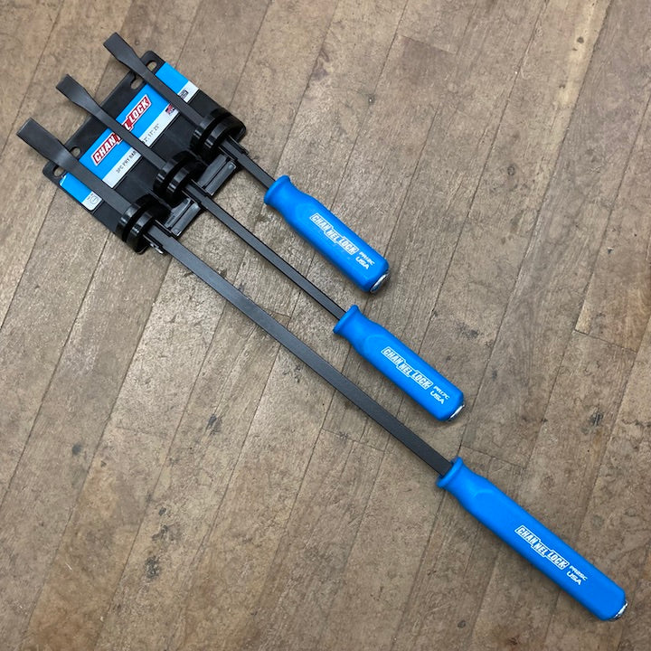

Three Piece Channel Lock pry bar set, looks like Wilde rebrand, on Harry J Epstein's for $45
Epstein's day tomorrow 4th of July has a 5% off Channel Lock coupon
