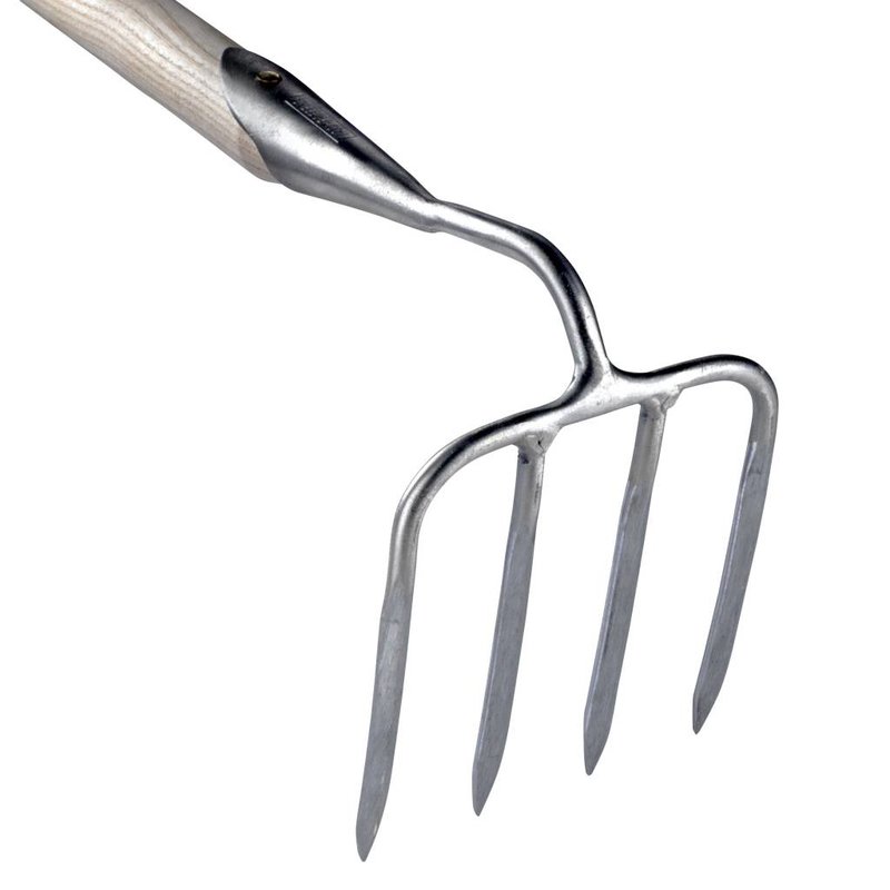

After we broke the excavator on a rock today (waiting now for a welder to come out and put the tooth plate back on) and killing a backhoe tire (tore the bead) and a few other failures, I got into the trench and started working to see how it would clean up. Lots of rocks about golfball to football size. Chunked them out, and started working the bottom of the trench (softer dirt and rocks broken up with the bucket teeth) with a weeding rake. It actually worked pretty good to bring up the rocks and push them off to the side. Ran back over it with a garden rake, and then stomped it down good. Smooth, level surface that won't cause any problem with direct bury, and I won't have to mess with conduit for the run, except I will sleeve it under the high-traffic part of the driveway. Probably going to get a load of sand and get my nephews over here toting buckets to cover the first few inches over the cable. They need a character building experience. ;)
Backfill is going to be a problem. It's about 1/3 rock, up about 18" cubes. Can't just push it in, will have a lot of hand-shoving.
Weeding rake like I used to separate out the rocks, FWIW:
