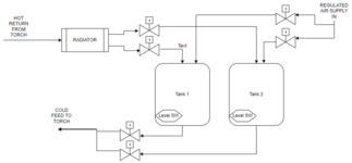

With trying to make things easier living with tendonitis/injuries, I am looking at improving my TIG setup. Mainly dumping my 26 air cooled torch for a less bulk/less fight smaller water cooled 20 size torch. I thought about going air cooled 9/17 rotaflex but I have been finding I am often duty cycle limited from needing to take breaks to ley my 26 cool down. The materials I weld vary so much as well that I would spend way too much time switching over between sized of air cooled torches. 20 seems like it would be a one size fits all solution for me.
Being cheap I am a slave to sunken cost fallacy and wasting time and money to try and find the optimum solution. Reading into the DIY chillers the pump is usually the crux of most projects and usually results in the buy one cry one aspect of getting a procon pump. AT that price, I might as well just get an Amazon cheapo chiller. I have some 12V diaphragm pumps sitting around, aside from the complexities of needing to add safety measures for a positive displacement pump, they are noisy, I don't like that!
This brings me to an idea of a pumpless setup. The setup would run off shop air and essentially be an air over coolant design to push water through the torch. When one tank is depleted a set of solenoids reverse the direction of everything; triggered by some float switches; and teh process repeats. As the amount of air volume needed is minimal, it would barely cause the compressor to cycle more than it will when running tools I would be working with anyways.
Here is a simplified diagram of what I am envisioning. Things like wiring, interlocks for flow, directional solenoids, etc... are omitted for simplicity. Control wiring should be easy enough with a little relay logic. + Getting a couple gallon'ish tanks that can be safe at 50psi should hopefully be not that hard (sunken cost fallacy anyone?). Is there something I am maybe missing here that would keep that silent system (aside from some PC fans) from working?
APEowner
Oct 2, 2009
4,169
Sunny, New Mexico
That's interesting. I think you'll need to not only close off the air supply to the empty tank but also vent it so that it can refill but otherwise I think that it would work. I'm not sure that the added complexity gains you anything over a conventional system however.
Yes, I would likely source some "directional valves so the closed position would be a vent for the tank. Just wanted to keep the concept diagram simple.
Theres other details to solve like, how does the relay logic start when both tanks are half full, or empty. Not showstopping but can be solved by either letting the relays race and one will inevitably lock the the other out first or just adding some on delay to one of the relays. As an EE by trade, I'll worry about the controls bridge when I get there.
As for your comment about gains. The gain for me would be removing the pump, and noise reduction. Valves and relays are cheap ($5-10 cad), a procon pump is going to cost me ~200 even before i source a motor for it. At that point I might as well spend $300 for the amazon solution.

While your proposed solution is quite clever, and I think it would work fine, I don't really think it's an "optimum" solution.
- You're worried about the noise, but how much noise is venting a gallon of 50 PSI air is going to make each cycle? What about the 6 solenoids that are going to be clacking away?
- Finding a gallon sized container that has all the ports you need, and a provision for wire pass-thrus AND can deal with 50 PSI of air pressure safely is going to be a tall order, unless you make something yourself, and trust something you make to hold air pressure.
- half-decent, brass-bodied solenoid valves are not exactly cheap - even for Chinese no-name valves. You could get cheapo plastic valves for $5-7, but do you really want to do that? Realistically you're going to be $120+ into this project in valves and relays. Now factor in the cost of acquiring/building your pressure vessel/tanks, and you're easily well over $200.
- If a hose pops off the tank or something breaks before the solenoids - you will not be able to stop the system. You're going to have 50 PSI worth of air pushing on a gallon of coolant, and all of the coolant is going to come spraying out no matter what.
Ultimately I think you're going to end up with a "project" that takes up a lot more space, makes more noise, and is more unreliable.

- Noise, Its 1lpm@1ATM for the fillling tank and 1LPM@50PSI a diffuser will have this being a light hiss. As for teh clikkity clack of relays. a 1gal tank would have a periodic click of all valves and relays changing over about every 4mins.
- The tanks as you mention are absolutely gong to be the crux to this. My hopes is that I could find/repurpose something on the cheap. Basically the qualifier before building this.
- Solenoids. Brass bodied ones are an option at 2x the price. I have had good luck with the plastic bodied ones in the last 6 years or so, one running 120psi duty as an auto-drain on my compressor. I've had a couple bad ones and they usually almost fail out of the gate if they are bad.
- This is the same problem if a pump based system decides to pop a line and dump a gal of coolant. A gallon of coolant on the garage floor is not the end of the world either. Its also possible to have a low pressure switch to shut things down.
- I am in Canada. That pump you linked is going to be $350+ CDN by the time it gets to my door.
In all, its about $100 in solenoids and relays (i have most of the electrical sitting around already). Another $60 for a couple level switches and a regulator. The tank, yeah the tanks might be a pain to source on the cheap.
You're thinking as if it were hydraulics. It's different when dealing with a compressible fluid like air.
When a tank fills up, and gets switched to pressurized mode, you need to pressurize the tank fast. The entire "air space" above the coolant needs to be instantly pressurized to 50 PSI in order to keep flow continuous. Once it's pressurized, yes, the flow is only ~1 LPM @ 50 PSI. But it will have a high initial in-rush of air, every cycle.
You have the opposite issue when a tank is nearly empty and needs to vent/dump the pressure. When you're venting the "empty" tank, you can't vent 1 lpm @ 50 PSI through a diffuser. You need to dump the entire gallon of 50 PSI air instantly. This is because any air pressure in the "vented" tank will reduce your pressure differential across the torch. You need that ~50 PSI differential to keep an adequate flow through the torch. Dumping a gallon of air at 50 PSI instantly is going to require a high flowing solenoid, and a good muffler to keep it quiet.
Fair enough. However, you can just hit the power switch and the pump turns off. If a hose pops off your pressure tank, all of the coolant will come spraying out uncontrolled. Small issue, but still a consideration. Most pump based systems have a reservoir below the pump, so they can't just dump all the coolant out if a hose pops off.

@American Locomotive, yes, I completely overlooked teh accumulation and blow-off at each cycle change. That's starting to sound like it can get old quick now.
