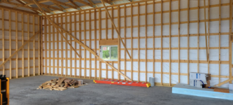

I'm in the middle of construction and I noticed the other day that they started putting housewrap and metal siding on the garage but it doesn't have any sheathing. It has 2x4 purlins every 2 feet. I initially didn't think much of it but I'm starting to wonder why they didn't sheath the structure. Wouldn't sheathing make much more sense for a insulated/finished garage? I am wondering if I am going to have any problems if I don't have them put sheathing on instead of the purlins.
For reference this is in central minnesota, we get decent wind and snow. I just don't want my garage to crumple on itself in the first windstorm.

I dont know where you are located but I would be surprised that it would pass inspection without some type of shear panels. I have seen them like yours on pole barns but yours appears to be stick built. I dont know if the metal siding would pass as shear paneling or not.

Are the carpenters done? If that picture is your building I'd be wondering about the missing diagonal bracing unless their calling what's pictured done.
Those diagonal braces provide the shear and racking capability. This is not an unusual construction technique.

Building have been built like your style for ages without issue. It's not the best by any stance however gets the job done cheap.
You current wall has 5in of space. As it stands it has an R5 value were studs are.
If you want an upgrade, open cell spray foam is cheap and will air seal with some R value.
If you want to upgrade from open cell spray foam go closed cell foam. You'll get air and water vapor and sealing with huge r value increase and wall rigidity strength.
If you want/need insulation the next upgrade is closed cell spray foam [no more than 3in] and rigid foam [I believe your location requires 4in rigid foam] on exterior then metal panels. This will cost the most but get you whole wall R value north of R20.

I talked with the builders and the current plan is Batts and then finish the inside with tin mounted on purlins around the inside.
It seems at minimum I should make sure some diagonal bracing is installed before the walls are finished. I guess I could have them osb over the insulation to provide additional racking strength.

FWIW, what was said was AIR TIGHTNESS is mandatory. Sheathing does not really do that, but it's sure a whole lot better than nothing.
I have to presume this is a metal building, so the exterior doesn't add much strength, and it's obviously stick built. So it has to be diagonally braced, and it's not. What you have now is obviously temporary bracing (crosses the window).
Joe,
I could see that if they were set into the studs but I dont know about the way they are there. Look like temporary braces to me ? I had them when I was building my garage to keep things straight until we put the T111 siding up.
