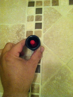

I'm having a problem with my stud finder... I realized that most new construction I'm dealing with has metal framing for the drywall mounting vs wood.
Simple question how in the world do I find these spots to mount sometHing on the wall ( ie bike rack, mount for my roof coil extension cord etc..)?

The magnetic toggle ones work great.They work even better when turned 90 degrees from that pictured above. Ran horizontally across the wall magnet will center in the vee when it finds the stud. Be sure to use fine thread screws into the steel studs.

I did a review of the StudPop on my site LINK
Its a great little tool, I just used it on a good friends house installing 5 LED tv's, he house is all new construction and has metal studs.

I went to two different big box stores to get one of these because I wanted to find the screws to remove some drywall without destroying it. I couldn't find one and asking the staff they looked at me like I wasn't speaking English.
I happen to stop at a garage sale on the way back home and found two for a dollar :)

I appreciate the feedback. The last garage I did was concrete walls and the house had wood framing. These houses down here for the past few years have even built with metal frames vs wood, so throw out my regular stud finder. Now our new property is being built (townhouse) and I noticed the framing was all metal, so I'm going to have a problem I think mounting heavy items on the roof or walls. Here is a pic

How do you guys mount something heavy on those metal studs?

If sheetrock is not up, you can do blocking behind the studs for location that you know you will need to attach stuff too. Like so.
http://www.wilkersonproperties.com/SanteFePark-Lot 32/Sante Fe Park - Lot 32 04-20-09 01-t.jpg
I know you can't always plan for everything, and sometimes it is too late, so you have to use the proper anchor.
watch this vid for Hilti toggles.
Home Depot and Lowes have their own versions. They all work fine. I only whip out the Hilti when I need to secure something precious. Like my 50" TV on a swing arm bracket that weighs 100lbs by itself. I used 8 of those toggles without any studs, or blocking on 5/8" rock. Trust the force.
If you plan on attaching something permanent, say an overhead cabinet. Construction Adhesive is the sauce. My go to is PL Premium. Once the glue dries, all your screws are purely for decoration purposes. Even if you remove every screw, plan being ready to take a section of wall off with the attached item. Don't ask me how I know.

This is definitely the place where a magnetic stud finder will be the best solution.
The studpop or ch Hanson are best. The studpop has the added benefit of giving you more info like where the screws are.
