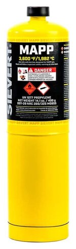

I bought one of these yesterday. Yes, no?

Sorry, "real" mapp gas isn't available for purchase anymore. What you have is "map pro". I didn't know they were labeling them that way. If you read the label, it does say propylene, which is the real identifier.
:( I've calling some DIYers I know to see if I can borrow an O-A setup; so far no joy. I really hate to have to spend $250 for a used setup plus have to deal with CL/FBM morons.
