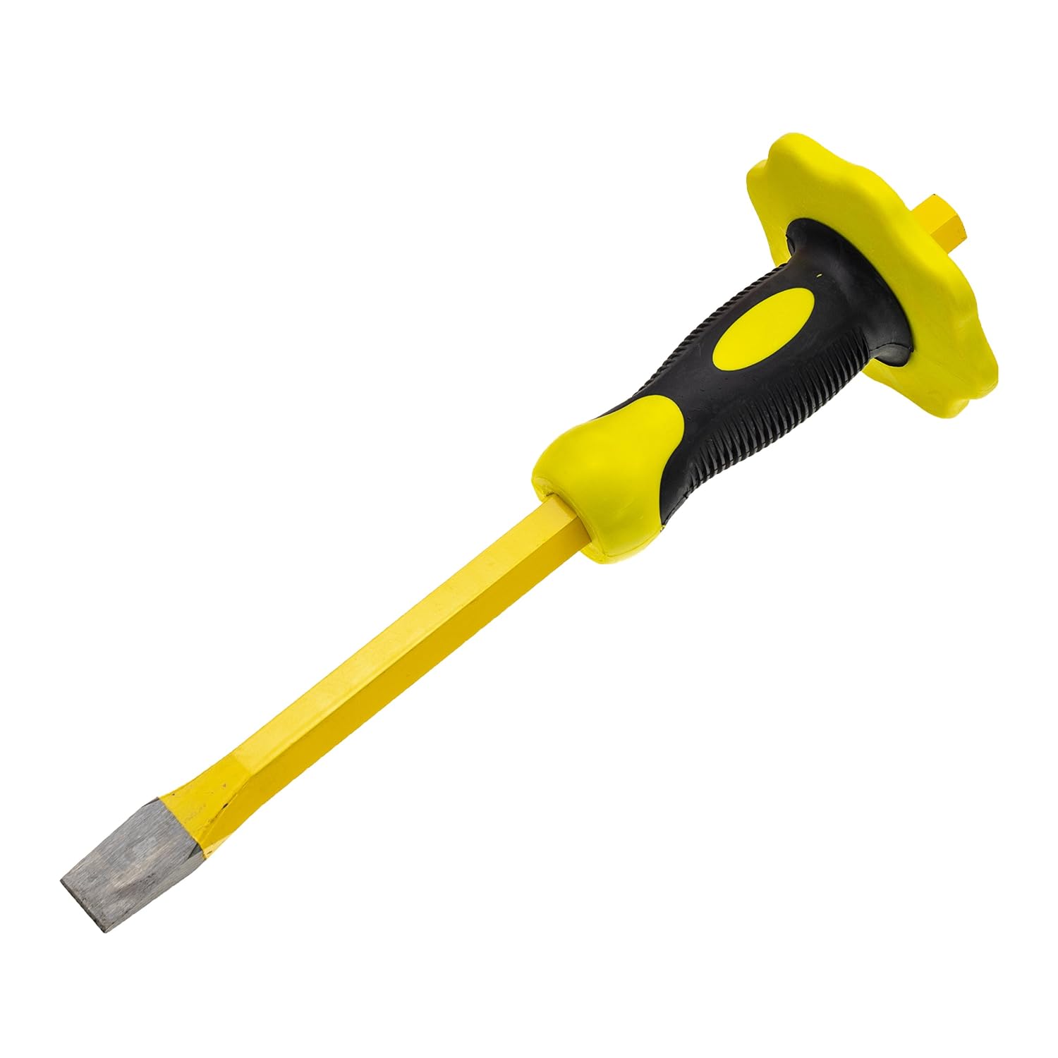

I used hammer and masonry chisel.....tap tap tap tap tap...one like this....

I don't think I want to hire it out. The chisel looks merciful... I don't think I've ever seen one with a hand guard! I thought maybe I could just buy a special hole saw but drilling the perimeter and tapping out the center seems like a good idea, too. I can also look to rent a machine.
