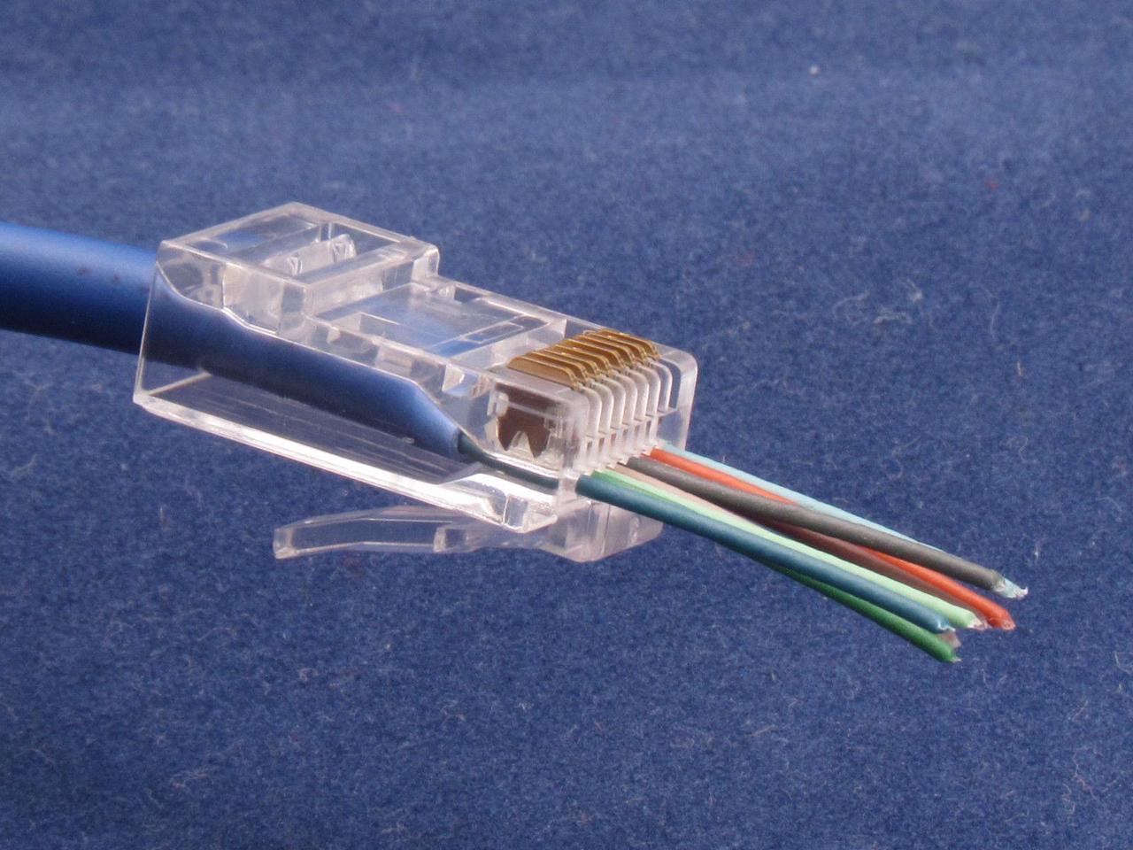

you'll still needed a crimper and some connectors ...
just pennies for the connectors at least for the CAT5 ones if you find some... cat6 and up are bit more expensive I think... you can find on ebay for $20-ish per 100pc or 50pc don't remember... if you are not that skill in those connectors... they do have those pass through ones for a bit more... that you can for sure the wires are proper before it is crimped
Pass through ones are something like this, there are also shield and non-shield... sheild one have a metal clip, non-shield ones doesn't like the one in the pic.
