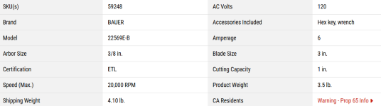

I think this would work for many uses.
The advantage of the Dremel is that its many bits/discs do many different things. Yes, they aren't made for all-day usage, but they are relatively inexpensive, have many attachments, are small-enough to fit in confined spaces, and you can also get the flex cable that gives you some freedom in the use of the tool. I usually leave the flex cable in-place, and only rarely use the motor hand-held unit alone.
I used the Makita too, it's more of a continuous use item, w/more torque. I've never had the need to use a Foredom, but that's a rugged tool, longer-lasting than a Dremel.
My oldest Dremel-style tool is > 60 years old, a Sears Roebuck die-cast case I got new as a kid. It is a back-up these days.

Lots of suppliers of cut off disks for die grinders. The three inch disks are pretty large for 20,000 rpm in my experience. 2 inch ones aren’t much bigger than the Dremel. Dewalt, metabo and Makita make smaller units than the one I mentioned previously. I’m personally not a fan of the battery powered grinders. But as a step up from a Dremel, they are certainly that, as is the Foredom. Pneumatic ones are great if the air hose is not a problem, and you have a big enough compressor.
Only mention this tool because the OP stated he was cutting bolts and bushings, which a Dremel style tool is not really suited for.
I have the $18 "Chicago Electric" version perfect for cutting bolts or small cuts in sheet metal, but agree no other functions of what the small interchangeable bit power tool could do.

This is excactly what I thinking, Bauer has both a corded and cordless version. Bigger and beefier than a Dremel, but still smaller and handier than a 4-1/2" angle grinder.
