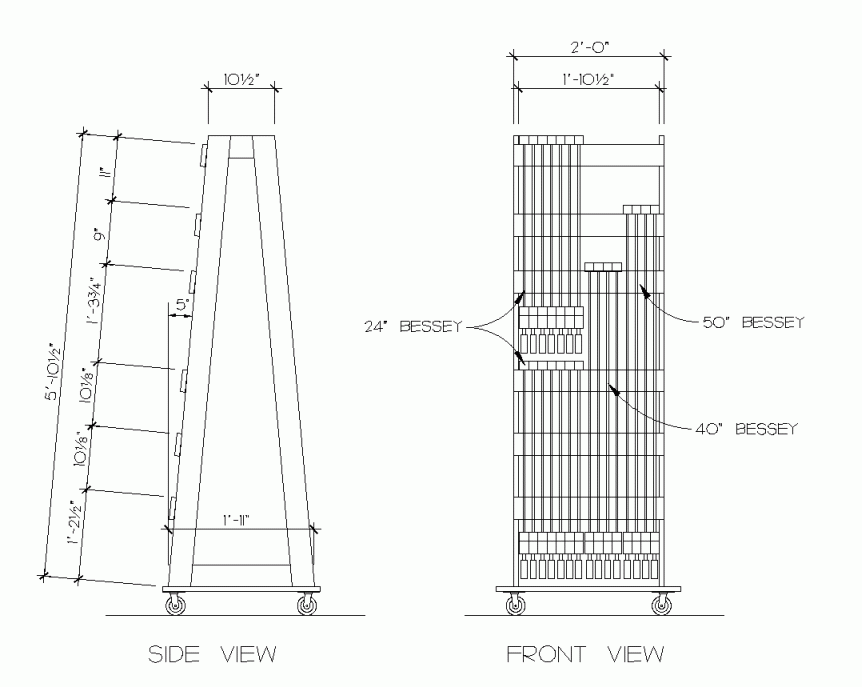

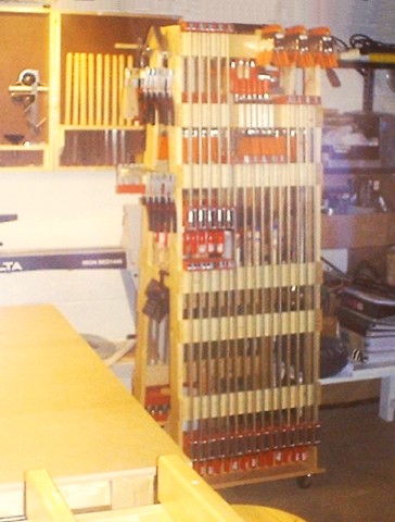

If trying to get enough of each type, I've got dozens and it is quite a stack to store.
You need to build a clamp cart like this...

Nice wood clamp rack! Also $200 for 30 Bessey clamps is a good price I think?
Oops, it was $200 for only 14, sorry.
