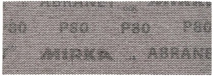

K13
Oct 24, 2007
2,227
St. Albert, AB Canada
Now there is an idea. I didn't think they made them in full sheets. That would save a lot of time. Thank You.
You're welcome. If you have any difficulties finding it let me know I know the Mirka rep out West and also know a good friend of the Quebec rep so I can find out where it is available in Quebec.
