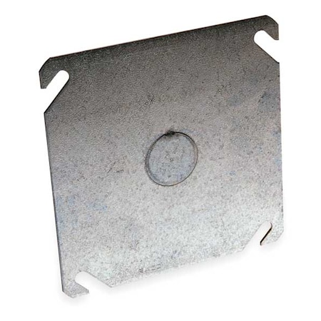

So I was going to say you can just use a 4" metal box with a cover like this too put a whip on, or one of the side conduit holes and blank cover.
However I do think you are required to have a disconnect in sight of such a compressor. Unless, the starter have a switch on it to prevent the motor from energizing, which could satisfy this requirement?
