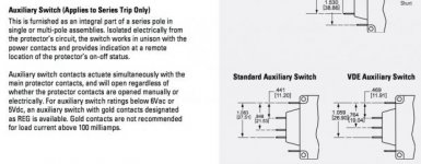

Hello. I currently have the circuit breaker depicted in the first photo for a small 2500 watt generator (the one in my hand). It is a single pole circuit breaker. The switch has broken off.
The 2nd photo shows a new one from eBay that has the same specifications (240 volts max, 20 Amps, 25 trip Amps). The only difference are the 3 steel tabs on the back.
1. Can I use the circuit breaker depicted in the 2nd photo if I tape off or clip the steel tabs in the back?
2. What are those steel tabs on the back of the circuit breaker in the 2nd photo?
Thank you,
Allen
