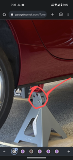

Lots of people forget, bend in this tab so the dynamic part can't slide out and land on your toe.
Screenshot_20230603-193524.pnglots forget; bend in this tab so the dynamic part can't slide out and land on your toe
