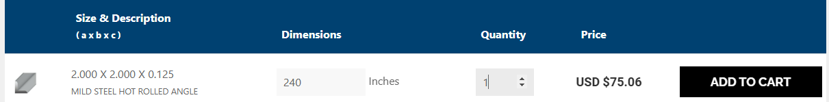

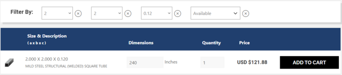

Yeah looking at the website if you buy a 20 ft length of 2x2x.120 mild steel it's like 121.**. if you buy 2x 10ft sections it's 122.**. they are only charging a little over a dollar for the cut.
It seems that they only start raising the cut price when you aren't buying the full 20 ft length.
I would of course prefer to buy the full length so that I can have leftovers for other projects down the line.
shoot summ
Jun 8, 2010
2,971
Interesting, I can't price .120 online, but .125 is $75 for 20'.
