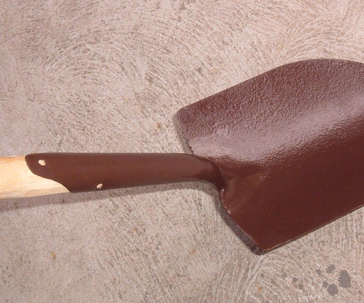

I recently found this super heavy duty shovel head at a garage sale. My question is, do I just drive the handle into the socket? Or shave it to fit as is? I’m assuming the handle is split back there to allow for a better fit. I’ve never rehandled a shovel so any advice would be welcome. The second picture shows how far the handle fits now.

I've replaced some handles. I fit them as good as I can with a hand plane and sanding . you can tell where you need to shave material by twisting the handle in the neck of the shovel . once I'm satisfied with the fit, I mix up some epoxy , smear it on the handle and tap the **** end of the handle on the ground with the shovel attached to drive it on tight .
let it set up, then drill for the rivet .
drill into one side a bit , say 1/4" . line up a pin in a vice (same size as the drill hole ) with a bit in your drill press. drop the partially drilled hole over that pin. line up the other side & drill it all the way thru . insert rivet

Sand/shave/grind it down to a tight, friction fit. Hammering it into the socket will just expand the socket--permanently. Shovel sockets aren't spring-steel.

Ok thanks for the insight! I could tell by the weight and the welded gusset on the back that this wasn’t an ordinary shovel. For $4 I couldn’t pass it up. With the handle I’m still under $25 for the whole thing. Not bad considering what Chinese stuff is going for. I’ll sand the handle clean and use blo as well.

For comparison, here's the back of my favorite, TT #2 Spade:
Same idea, different execution. I've broken a few shovels without the reinforcement right at the base of the socket.

^ Driftpin has it - drive it in and put a soft rivet in it and peen the rivet over.
I've never used glue on a shovel.
My bow rake on the other hand, had to be epoxied and riveted to keep the head on. (I'm not easy on tools.)

I'm in this camp also. I like the end of the socket to hit the shoulder on the handle, but only drive it 1/8" or so . Saves wear on the river.

Thanks for this tip on drilling the rivets. I didn’t even consider it might be difficult to line up in one shot. This technique worked perfectly. You saved me some headache for sure.
