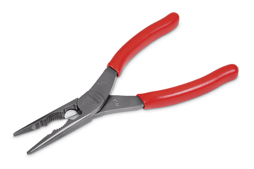

I've got a pair of Snap On Talongrip pliers and I've notice the tips don't touch, the jaw is straight but there is a 1mm gap all along, between the 2 sides. Just wondering if this was normal.

The tips should touch, but use the < search > function

IIRC, Talon Grip refers to the soft red vinyl grip handles.
Battery pliers come to mind as an exception where the tips should not touch:
But a picture from the OP would really help things along.

Talon Grip refers to the sharp cross-hatch machining on the jaws.
I have several pair, including the exact pair pictured above, and they all touch just on the tip. They can be brought into full contact with hand pressure if need be.

If they're needlenose, the tips should close

Only the tips should touch. It's a design feature so that the jaws should squeeze parallel if you grab onto something wider.

Many plier brands design their pliers so the wire cutters touch just before the tips touch so the cutters do a good job cutting wire, it is not necessarily a mistake.
The way they are in the pic above, the tips touch first and then continued pressure will still move the cutters together...
That's how it works with needle nose pliers, like in the picture.
Lineman's pliers are not flexible enough for this, so the cutters meet first, and the jaws never meet.
Not too long back, a friend showed me a pair of Husky needle nose pliers where he complained that the tips didn't meet (these had no cutters). They clearly had been overtaxed, but the easy fix is to open them up, shove something in the back of the jaws (I used a nickel), and force the tips all the way closed. If you use the right size shim, you can bow both jaws together in a parabolic curve such that the tips will meet first, and as you increase pressure, eventually the whole length of the jaws still comes together.

Here are mine. What a joke. Here is the quote directly from snapon's website.
"Jaw tips are perfectly aligned and feature machined teeth for precise gripping strength with positive control"

Not right, have SO replace them.

A lot of this is simply the realities of tolerancing. If the cutters are in contact, the tips cannot be, or vice versa. They can only be within a tolerance limit which can't be zero, not even in Japan. Until something flexes, like the tips, to take up the tolerance.
That said, the pic shown is most likely outside SO's normal tolerance those.
