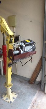

Good morning,
I would like to replace the hand crank winch on the cherry picker in the photo with an electric button-controlled winch. As you can see, the current hand crank winch is mounted on the mast of crane, with the wire rope feeding upward and through the shaft of the jib. I have two questions about replacing the current hand crank winch with an electric controlled winch.
1. Can an electric winch such as the Harbor Freight model shown here (http://www.harborfreight.com/1500-lb-capacity-120-volt-ac-electric-winch-96127.html) be appropriately used in the current position of the hand crank winch? I ask because most photos of an electric winch on a cherry picker show it being mounted on the jib (portion of the crane horizontal to the ground), where the wire rope feeds out and is horizontally to the ground.​
2. Assuming the answer to #1 is “yes,” and an electric winch can replace the currently location of the hand crank winch, would you have any reservations about purchasing a 12 volt DC winch (much cheaper) and simply using a DC to AC converter so I can plug it in for use in my garage? There are far more options (many cheaper) for 12 volt DC powered winches.​
I’m not sure it matters, but the application would be to lift and raise generators and other small gas engine machinery, which I repair and sell as a hobby. The weight will be maximum 250 pounds per lift. You can assume the winch will be correctly bolted on the cherry picker.

Thanks everyone for their feedback. After the original posts, I searched instruction manuals for several electric winches and although some come with a locking feature, all of them instruct to use only for horizontal dragging--and not to have weight on the winch when not in use. So I will search for another solution. This hand winch uses planetary gearing and takes very little effort to turn. Now I am thinking some sort of low RPM motor may be a good solution to turn my existing manual winch. But like most things, this is morphing from a quick improvement with a couple bolts to a major project. I'll may decide to just leave the hand crank :)
By the way, this is the crane (see link)- it detaches from a base and is intended to be mounted to a truck. The winch is needed because the crane tends to tower above the item you intend to lift from a tall truck bed. I have a mount in my truck and welded a stationary mount for use in my garage.

Appreciate the feedback. I'm really set on having that jib crane used to move equipment. I have limited space and an ideal spot for the crane in my garage that would rotate it to the bed of my truck, to the garage floor, or on my workbench.
Because the crane will likely outlast my hobby, I want to install a hoist (rather than a winch) for safety. I feel confident I could keep from under the winch, but over the next 15 years, I'm not sure the next owner will have the same caution.
I am purchasing this hoist from Northern Tool here in Austin. They have a floor model on sale for $111 and tax. And the hoist is made specifically to hold a load. At 550 / 1100 pounds it meets my needs. Once I purchase, I will likely create a post for advice on securing the hoist to the cherry picker (replacing the hand winch depicted in the first post of this thread).
The hoist position on the crane will be configured similarly to the third photo on this website. It will be set in an inverted position with the wire heading upward and through the crane body. I'm sure I will need to have a weight on the end of the wire to ensure there is always tension on the rope.

Maybe I'm just not very creative but I don't see how you're going to secure that hoist to that lift. Also, unless it's spring loaded, the up limit protection bar might prevent it from working if mounted where that hand crank is now.
From that page:
"This electric hoist is only intended to be attached to or hung from a 2" diameter pipe"

Securing the hoist will involve a few welds to a make a supported steel platform. The hoist has bolt holes on the bottom that will be used to secure it to the platform. The guard you are referring to does in fact have a spring keeping it erect upside down. It takes about 5-10 pounds of pressure to fully actuate it. It can also be easily removed with a hex wrench.
A
apittmanii
Dec 28, 2015
110
Thanks everyone for your feedback. I went with the 550 / 1100 pound hoist and welded a platform using 5/8 steel plate and a supporting brace underneath. Works very well, especially since I have limited space (1/2 of a 2 car garage) and the crane pivots wherever I need it. And it is located in a corner where I am unable to stand behind it to crank a manual winch. I lifted a 275 pound generator very, very easily, and nice piece of mind knowing the hoist is designed to hold a load. Means I can crank up a generator and work on it at eye level. I bolted the entire jib crane to the floor of my garage.
