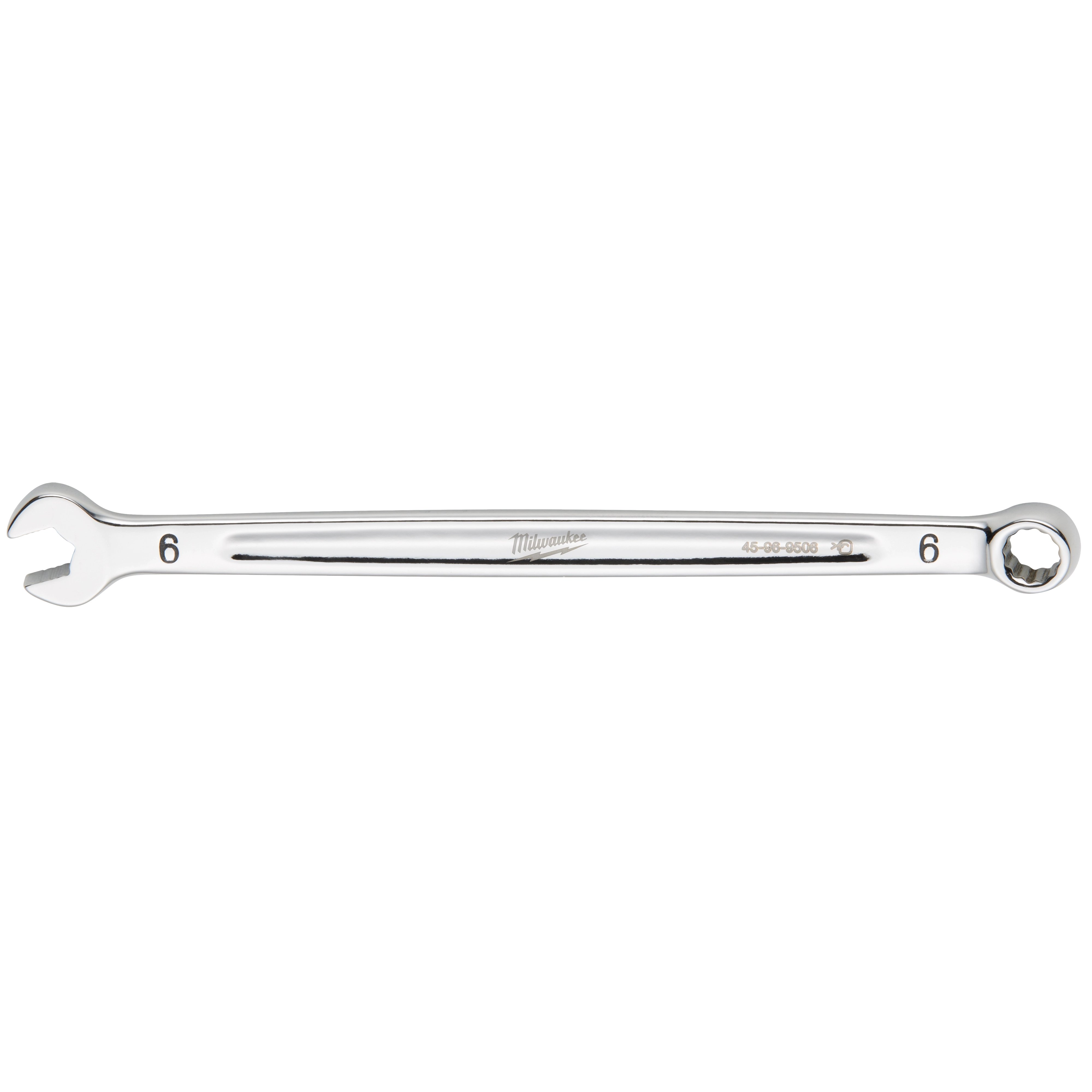

I have a question about wrenches in general. I see in comparison photos the some wrenches are scalloped along the beam, KTC, Stalwillie, and others are not, Snap On, Wright, Gear Wrench, etc, etc.
Is there a comfort difference? I know this is personal preference and subjective, but it seems to me that having the middle of the beam scalloped out would be much less comfortable. Do the ridges dig into your hand when pressure is applied?
The above question transitions into beam thickness and width as a variable that provides or detracts comfort. Subjective again with hand size,and work environment somewhat dictating comfort level. ( I have bigger hands and feet so you know what that means……bigger gloves and bigger boots 😂🤣😅😁🥾🧤).
Is there a strength quotient that improves scalloped wrenches over non-scalloped much like placing a roller bead in a metal panel to impart strength?
It also seems that a wrench with a scalloped beam would be more difficult to clean after use, gathering oil, dirt and grime within the channel?

are you talking about this style of scalloped wrench?
I have a USAG set, a MAC long pattern set, Proto ratcheting set, and the Metric Milwaukee set that are all eye beam shaped. I think the wrenches are more comfortable to use because the I beam area forms a natural resting spot for my thumb. The beam edges are slightly rounded so, there's no knife edge to contend with. The MAC, Facom, USAG, and Proto ratcheting versions have a slightly different offset to their open ends which I think are easier to manipulate in certain circumstances. I haven't found them to be more difficult to clean at all. I haven't encountered any of the negative issues you mentioned but, it's also a matter of personal choice. I know the MAC precision Torque series of combination wrenches are popular. :beer:
