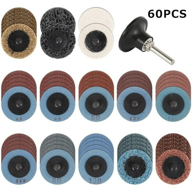

Dumb question probably. I see the guys on the hot rod tv shows using these little air powered sander/grinders with about a 2” diameter disc/wheel. Looks very handy in tight quarters. I haven’t found anything in the stores that looks just like what they’re using. Does anyone know exactly what they are? And where I can get one?

Definitely right angle, pistol grip, but not orbital. Small. Almost a die grinder but right angle with a small sanding pad. I just don’t want to buy something and find out it’s not what I thought. I’m bad about pulling the trigger on Amazon too quickly.

Like this?

OP, are you referring to the cut-off wheels like Robby321's link has?
Or the surface prep pads (come in 1", 2" and 3"? Can be sander paper, sctochbrite, bristle,flap wheels, etc

More like the surface prep. Or a disc you would use to grind a **** weld smooth on a body patch panel. I generally use a 4” electric angle grinder with an abrasive flapper wheel but it’s often overkill and not good in tight places.

Bob, I’m confident that’s what I had in mind. Air angle die grinder with 1/4” chuck and the roloc surface prep attachments. Thanks a bunch.

Just be sure to pay attention to which kind of Roloc type attachment you buy.
The backing pad needs to match the pad, ie most common -TR (male mount on pad) or TSM (female mount on pad).
Great tool, enjoy. Quality ones are great if you are doing it all day everyday, but the cheap ones get the job done too.

I buy the Roloc discs from Amazon.
