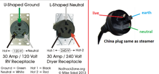

US 240v is NOT 4-prong. It is 3-prong. hot-hot-grnd. US 120/240v is 4 prong hot-hot-neutral-grnd

H
handyman2020
Sep 22, 2019
222
Toronto
this is what confusing me, usa has two 120v phase which makes 240v
China single 240V and then neutral. thats it.
how will this machine work in north america :(
it can work in 120v outlet with adapter but then it will be only 1500watts not 3000watts

USA and Canada have single phase 240v; often called split-phase because it's grounded in the middle to give 120v 'halves'.
The machine doesn't know the difference between 240V from two line conductors, or from line to neutral. It's the difference between the two that does the work.
dcg9381
Jun 20, 2018
12,035
Austin, TX
In the US: It's considered "single phase". Yes, in the US it's 180 degrees off to get a potential difference of 240V so it's confusing. We "split" that phase to get to 120V.
It reads to me that China's standard is 220V AC @ 50HZ: It really doesn't matter that they're calling it a neutral because the potential difference between the hot and that "China Neutral" is 220V AC. There is no "split" option in China...

China operates on a 220V supply voltage and 50Hz. line to neutral.
Their line to line voltage is 380.
so will that machine work or not with some modification to the machine plug as well as some modification to nema plug I have.
I am confused by your reply now :(

Actually that is how a good chunk of the world is for single phase. It is your guys 120 that becomes the head scratcher, What I often see on anything "global" is it will say 120-230v 50-60hz and you just buy the plug that fits your wall or there is usually a voltage switch.
William Payne
Mar 15, 2010
7,980
Wanganui, New Zealand
That plug on the right is what we use here in New Zealand and Australia and the earth and the neutral should be the other way round in that image if it was for our country.
(EDIT) I just found out that some places that use this style of plug do in fact have earth and neutral reversed compared to AU/NZ, One example being Argentina apparently.
In fact sometimes some electrical goods don't have an earth at all unless there is a shock risk.
If its 230v like it is here in New Zealand than 240v here is L1 N and Earth. We don't have any lower than 230-240v stuff here. Split phase being L1 L2 and Earth is 400 volt here.

That plug on the right is what we use here in New Zealand and Australia and the earth and the neutral should be the other way round in that image. In fact sometimes some electrical goods don't have an earth at all unless there is a shock risk.
If its 230v like it is here in New Zealand than 240v here is L1 N and Earth. We don't have any lower than 230-240v stuff here. Split phase being L1 L2 and Earth is 400 volt here./recept
The plug/receptacle used in AU/NZ is a obsolete Hubbell patent.

Hey thanks for that. I am going to look that up. Hey if it works it must be good haha.
The use of them here slowed down after the 1960's, they don't even have the same 20A 250V rating anymore, now they are a 20A 125/250V, dual voltage, non grounding device, and considered a non NEMA device.
