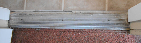

30,058
This is the entry way in a commercial building. the tile is ceramic. this is on an upper floor, so that cement floor on the outboard side isn't exposed to rain.

Cement based grout will never stay in that long term. That Aluminum threshold moves and expands and contracts so much grout will never stay put.
I doubt anything will really work like you have it.
Threshold You need something that overlaps the tile, or something that butts up to the tile with a smaller gap that can be filled. The one linked is a good option.
coldh2o
May 21, 2013
1,460
Ontario, Canada
Another vote for replacing the threshold and/or using caulk, not grout. I don't see a 1/8" lip as being a trip hazard, but you can probably find a heavy caulk that could be tooled enough to eliminate the lip.

okay... obviously I need to take a different approach on this, because those girls may as well be jumping on that threshold plate - note that the inboard most screw is backed out about 2 turns - that end of that aluminum plate is loose.
fortunately the rubber-backed mat that's in that entry way covers up that seam so it's not really exposed.
and yes, 1/8" of an inch is all the difference in the world when you're dealing with dancers.
sounds like what I need is some sort of a heavy-bodied caulking compound that will set up in there.

After seeing that, I would caulk it then cover it with a flat aluminum transition between the tile and threshold. Carpet section at the builder store should have those transitions. Once covered, you will never have to deal with it again.
