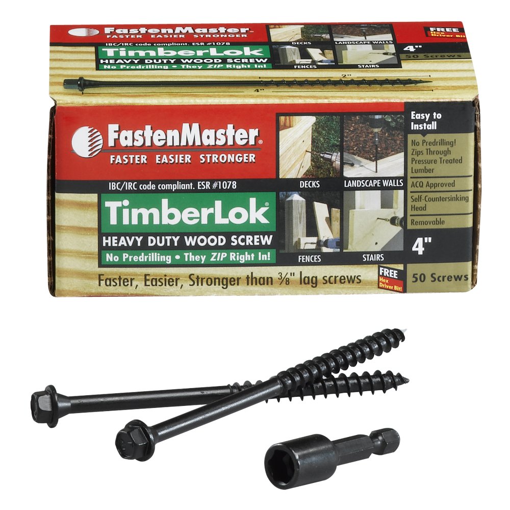

I have a cracked 2x6 rafter in my screened in porch.
In the past when I've sistered rafters I've used construction adhesive to bond the sistered rafter to the damaged one, along with bolts.
These rafters are all painted though, in a yellow latex paint.
Do I have to somehow strip the paint before applying the adhesive? It will it be ok?

I would scrape or sand that off for several feet in each direction.
Also nice if you can sister from both sides if it isn't a full length replacement.

Wouldn't hurt, as you want your bond to be wood to wood, and the latex paint will be far weaker a bond to the wood (either wood) than the epoxy would be wood to wood (I've seen latex bonds so weak that they will actually peel off in a decade or so, sometimes less). Depends how hard it is to remove the latex, but if it's possible, then I would.

Does anyone make a construction adhesive design for this situation?
I think the latex may have lead under it which makes this a much more involved project.
How much structural benefit am I giving up if I just bolt it up with no adhesive?

the longer you make the sistered rafter the less flex there will be, therefore the glue becomes less important. can you run a full lenght rafter ?
I would make it as long as possible and nail accordingly

Thanks guys. I can make a full length sister so I think I'll just skip the glue.

I would run the repair the full length if at all possible. I would sister a 2X6 on each side of the damaged 2X6. I would use nails but I would use a nail gun and nail the **** out of it. If you would like to use some glue, go ahead, it won't hurt anything, but I wouldn't bother scraping the paint off first. The nails should be more than capable of holding the whole thing together without any glue.

If you have a framing nailer, 50 or so nails (and three minutes) later, and you'll be fine. Just stagger the nail pattern so that it doesn't try to split the wood.
A bolt or screw every other foot or so first to keep things together is a good idea.
Glue won't hurt, no matter what you do with the paint.

Construction adhisive wouldn't hurt.
For hardware, I would either carriage bolt them together or use TimberLOK screws.

I'm gonna do a full length win timber loks. Thanks everyone. Love this forum.
