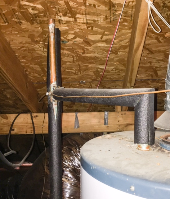

I am getting ready to replace my water heater and was curious why they plumbed it the way they did. The hot and cold come up vertically from the floor and the connection to the water heater is tee'd off that riser but the riser has a good amount of pipe above the tee. Why did they do this instead of using a 90* elbow. I assume there is a reason but I was not able to find the answer. Below is a picture of what I am talking about.
Thanks!

Sometimes that is used to try to avoid "hammering", where the pipes will vibrate or pound. The idea is that the vertical capped section holds air. The air is able to compress & act as a spring to absorb the shock.
Usually it isn't needed if pipes throughout are anchored properly & valves are in good shape. But it doesn't hurt & some guys will still include them. It used to be a lot more common. In a lot of older homes you will find these in the wall behind a sink.
Another possible purpose is for future add ons. Like an expansion tank or a new run to somewhere else. It can be a little awkward to add a T in the middle. Some plumbers leave an occasional T & cap in systems where they think it is likely to need to be added to.

Thanks for the tip. I plan on doing it that way it is now. A copper thread to sweat fitting and then copper pipe and fittings. It is all very accessible. The only ***** is going to be getting the old and new heaters in place. It is in the attic so will be a pain.
Makes sense. I thought about it for possibly helping with water hammer. It did not seem like it was a code thing as I could not find any reference to having to do that. Thanks!

It's for air creating water hammer effect. Air will raise to the highest point and if it doesn't have anywhere to go it will create a hammer effect and cause issues. They create that space at the high point so any air will go there and not interfere with the water flow.

It is there to provide room for water expansion.
If everything is turned off and the heater is full of cold water, bringing the water up to full temp can expand it a lot, causing a big pressure increase and a scalding danger when a faucet is opened.

Here's my 2 cents. I have heard that ^ before. In a closed system with a check valve before the water heater that might make sense. Although it doesn't seem like enough volume. An expansion tank would make more sense in that application. Pic below.
With an open water supply from the city thru to the HWH it would just push water back up the cold water pipe until the pressure balanced out, & the expansion space wouldn't be necessary.
With everything off a water heater should never be run at all. That would be taking a chance of running a dry water heater. The expansion space in that bit of pipe would make no difference in a water heater even partially filled with steam. Steam volume to water volume is about 1600:1. Hopefully a TPR would bleed of off enough to prevent a major issue in that situation, but that pipe doesn't seem like it would help if the TPR couldn't keep up. If you're not in a steam situation, then the volume is not nearly so great & the TPR should keep the pressure below 115 to 125 psi.
It might be why someone did it, but it doesn't seem like there would be many situations where it would help.

It isn't for water hammer, there would be air in the pipe at first but in a pretty short time, unless there is a bladder inside or a way to add air, the air would dissolve into the water and the pipe would be full. I put these in all the time, some I like to run horizontal for a few inches first then back to vertical either up or down, the purpose is so when the home owner goes to replace the tank in 10 years he is compelled to take pictures and post on GJ so people can make random guesses as to what the original meaningful purpose of this 12" piece of copper could have been.:D

that is an air chamber . your local code may require it but it certainly can't hurt. it wasnt done cause he ran out of fittings. also you could put a loose key vent ot 1/4" petcock to help in charging the chamber. if you get water hammer you shut off the heater drain the heater from a lower faucet open the petcock you put in and let the line drain .close the petcock . turn it back on

If that is truly installed as an air chamber it would work for a relatively short period of time. The amount of air that can be dissolved in water increases with the system pressure and decreases with a rise in temperature. So holding 50 lbs of pressure on cold water on a really small amount of air would mean you would need to drain your tank to recharge the vessel really often. A petcock would make it a little easier but still you would need to shut off the water supply, open the petcock then drain some water to refill the pipe with air, seems crazy to me.

In Texas I was required to have an expansion tank on my water heater because I had an in-ground sprinkler system, which had a back-flow preventer. Their logic was that since the back flow preventer meant that the city water system could not absorb excess pressure if my water heater got too hot, I needed another way to absorb the pressure. The expansion tank was not originally required when I built the house, but San Antonio added them into the code in about 2011-2012.

The backflow preventer means that there is no place for the pressure to go as the water heats and expands. The anti-back-flow device would be installed right at the pressure regulator coming in from the city water. The city is concerned about ground water (from the sprinklers, remote but possible situation) getting back into the system, especially when pressure is lost in the public main, and then contaminating the main and other peoples water. By using the anti-back-flow device this creates a closed system. The only pressure relief is the TPR valve on the water heater. A Bladder tank as illustrated above, or if you are on a well, you already had a means of expansion in the well water bladder tank, is a very safe way of allowing for expansion. When you install a sprinkler system, you most likely need a permit, and this creates an opportunity for the city to force you to install a Anti-back-flow device (and probably a regulator also). Otherwise they are not in a good situation to require every house to install an anti-back-flow device.
There was a point in time in the past where there was a toilet valve that was improperly designed and allowed water from the tank (think blue water from a bottle of Vanish) to get back into the public water system, during a failure of the water pressure (busted main, repairs necessitating a shut off of the water, etc) and this is one of the big reasons that anti-back-flow devices became a requirement. Its mandatory most places now, and should be.

Do I get to give my 2 cents? --------- To bad here it is. I don't believe it is for "water hammer" prevention, that would be at the end of the line at a valve that shuts off fast like a washing machine. Looks to me like "shoot I didn't bring enough 90s, I have these and I don't need to go back down to get more." Could be some future item, but going in that direction in the attic, don't look like it.

That is correct. As municipalities install check valves throughout water lines they (the water lines) can't handle the expansion of the water. You can also install a water pressure regulator if your incoming pressure is above 50 psi.

I think it's a bad attempt at stopping water hammer. I mean why make the distance between the tee and the cap as long as he did?
