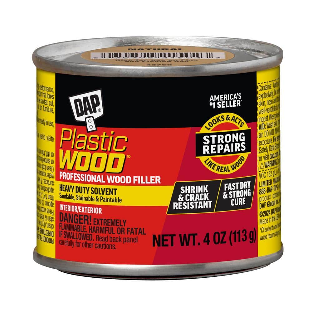

dogdog
Nov 15, 2011
12,711
there are stainable fillers, usually it is not the water base one, the stinky acetone smell ones in a small can that cost you about $10... Dap Plastic wood... you can thin it a little with acetone to make it easier to apply... smells though.
I have good luck with this one. but require sanding.
