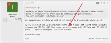

lol...I guess I am way off.....Total will be 70-80 feet including the drops. I wonder where I am off.
My very rough math was: 1/2 ID=.545, Area = Pi r^2: .2725 X .2725 * 3.14 = .23316 inches = 2.8 cubic inches per foot X 70 Feet = 196 Cubic inches / 144 cu inches per foot = 1.36 Cubic feet x 7.5 = 10.2 US gallons...... I figured it was high so I knocked off 20% to 8
What am I missing?
What am I missing?
Good work except for one error. Start with One foot is 12 inches.
one cubic foot is 12 cubed not 12 squared. So there are 1728 cubic inches in one cubic foot.
So you’re only off by a factor of 12 !!
What am I missing?
You trusted the AI definition?
inside diameter (ID) of a 1/2 inch copper pipe is typically around 0.545 inches.
Explanation:
  • When referring to copper pipe sizes, the "1/2 inch" refers to the nominal outside diameter (OD).
  • A 1/2 inch copper pipe will have an actual ID slightly less than 1/2 inch, usually around 0.545 inches.
I was going to check your math, but this gave me too much of a chuckle. Maybe later
Table from copper.org says 0.0121 gal/ft, x 70 gives 0.847 gal. Make someone else do the hard math.
Other tables may have a slightly different value, based on min, max or mean dimension used.

Lol....Cubed. Of course. Thanks!.
