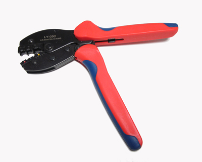

theoldwizard1
Feb 22, 2011
43,514
SE MI

I need to rewire my Harley.
If you are going to do a lot of wiring and YOU WANT IT TO LOOK NICE AND LAST A LONG TIME, use non-insulated terminals and marine heat shrink (HF). If you are using new wire, buy marine, pre-tinned wire (eBay). Yes, it takes longer, but it is much more professional looking.

This last is right, for good appearance if it is visible. I would not want people to see colored connectors everywhere
If what you want is something that crimps a regular insulated terminal near its nose, so that a ratchet crimper is not practical, I have used various T&B models. (But they cost so much that I would never buy a new one.)
