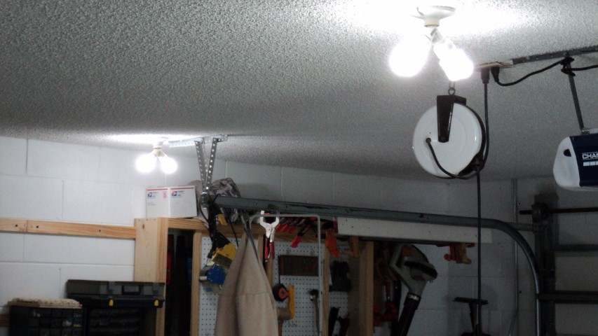

Only comment I have is the neighbor changed his bulbs to "Daylight" as the "Normal" ones seemed dim or yellow'ish. I never saw the stock lights, only after he changed them.
Beachside Hank
Jul 9, 2013
116
PALM BAY FL
My 2+ car attached garage is my wood/ work shop. I chose to install basic screw- in bulb fixtures because 1. They are easy to do and cheap. 2. In a “Y” tree, CFL’s illuminate just fine for me, a member of the over 60’s club. 3) bulb maintenance is as simple as reaching up , unscrewing and re-screwing. 4) when LED’s become affordable, I can make the switch effortlessly, and without additional expense or locating special lamps to fit my fixtures.
I’m experimenting with task lighting using the giveaway LED flashlights from H.F. They hold much promise since the power source is self- contained, an attached magnet mount means portability, and the life on a battery pile is considerable due to lamp efficiency. Plus not having to rig for line voltage feed is a great benefit.
My dust collector is old technology brute force extraction; no ultra low micron after filter, just a simple bag, which I slap down on occasion. No remarkable dust problems to comment about after 3 years running now. Believe me, my handler would let me know if dust infiltration was a problem as the laundry area shares the same space.
