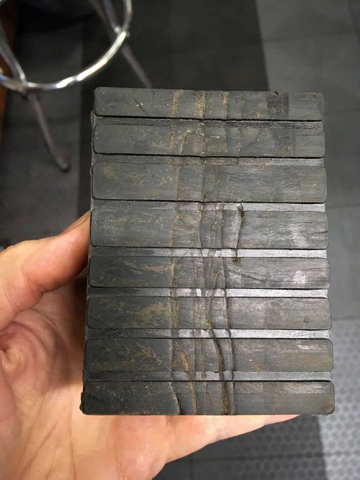

I just had a sobering experience with my Quickjack BL-5000SLX lifting my G37 sedan.
This is only the fourth time I've had the car on the Quickjack. I got it all lined up with the lift points, then raised it until the lift blocks made first contact. Went around and checked all four lift points to ensure they were well positioned. No problems identified. Then I raised the Quickjack to the first locking position and lowered it to lock. Checked the right side (locked) and was going around to check the other side when the left side jack SQUIRTED out from under the car and the left side fell to the ground! Right side still up on the jack. The jack SHOT out from under the car with its full weight on it. The front shot sideways about 4 feet until it hit my workbench. The rear followed and ended up about a foot away from the car. The Quickjack was still standing. It didn't tip over. It didn't collapse. The locking bar was locked, and the hydraulics were still connected. No leaks. Even if it had leaked, it was in the locked position. To get it to go down, I had to stand on it while my son pushed the down button on the other side of the car. So there was still plenty of hydraulic pressure in it.
If it had happened 3 seconds later, my face would have been right there checking the lift block, and it would have taken the full force. No apparent damage to the car.
There was nothing wrong with the jack itself. It was locked as intended, and showed no evidence of failure. The lifting blocks were also fine, and the grooves crushed into the blocks by the pinch weld showed that the positioning was within a quarter inch of the center (i.e. properly positioned).
It's pretty disconcerting to think that I spent a few hours under that car on that Quickjack last weekend. I will never trust it again, unless I can figure out how/why it happened. So far, I haven't managed to do that. I've read the owner's manual again, and I've Googled "Quickjack failures". No clues were forthcoming.
My only thought is that my garage floor has plastic tiles. They're pretty slippery. Sliding the Quickjacks to position them is pretty easy. But for it to squirt out from under the car with about a ton of weight on either side seems unlikely. There had to be a significant lateral force involved. But from where? With the jacks and blocks properly positioned, virtually all the force should have been vertical.
I'll have another look tomorrow. Until I figure it out, it's back to floor jack and jack stands!
If any of the engineers out there have some thoughts, I'm all ears!

For those of you who don't want to follow the link, here's what I learned today from further investigation.
The front left block was misaligned. Yesterday when I inspected the lifting block, I only looked at one side. The grooves from the pinch welds were right down the middle. But I didn't look at the other side. That side has angled grooves. Misaligned. Toed out. The pinch weld was sitting in the middle at the back and closer to the inside edge at the front. (pics on the myg37 site)
As the inside edge compressed, a small angular force would have developed. Combined with the slippery floor, it was enough to spit the jack out.
I'll be cutting grooves (or buying Quickjack's "accessory" blocks [they really should be standard issue since most cars have pinch welds these days].
I'll add some friction material to the bottom of the Quickjack.
And I'll never go under the car without good old jack stands!

Looking at the photos of the blocks I think there may be an interesting clue. There should be ONE indentation in the block from the pinch weld. But instead we're seeing multiple. This could just be multiple layers of metal that make up your pinch weld. But with my car it makes a pretty defined, single line. Seeing multiple makes it look like the jacks kinda shimmied under the car. Which I think would be congruent with misaligned frames or if they were not facing the same direction.
