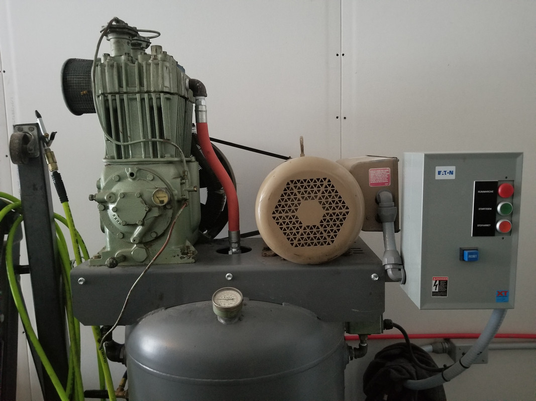

Hey Guys, I have a 325 Quincy setup that is giving me grief. A few things are going on. It leaks out the intake, leaks oil, and now it started randomly unloading. I have checked the oil level and it looks good, about the middle of the dipstick.
I know the leaking out the intake is caused by one of the valves, I took them all apart and tried to level them, but obviously I didn't do a good enough job, its better, but still leaks.
The oil leak I can look after. It was a slow leak, and then I tightened the bolts, but now its a fast leak. Again I can look after this, no problem.
But the thing that really bugs me is it is randomly unloading. It will get to about 100 psi and all of a sudden will unload. Then it will pump again, and then unload. at about 120 psi, it stays loaded until the 160 psi shut off. :headscrat

I wonder if the check valve in the tank is randomly sticking open and allowing the pressure to back-feed through the valves. Or possibly the relief valve randomly opening?

The unloader is hydraulic. Fix the oil leak first. The unloader issue may stop.

Don't see a check in the discharge line to tank so it's using the valve reeds to hold pressure back. Pull the head check the valves add a spring check. Pull the air cleaner block air intake see if the compressor knocks if it knocks rod problems.

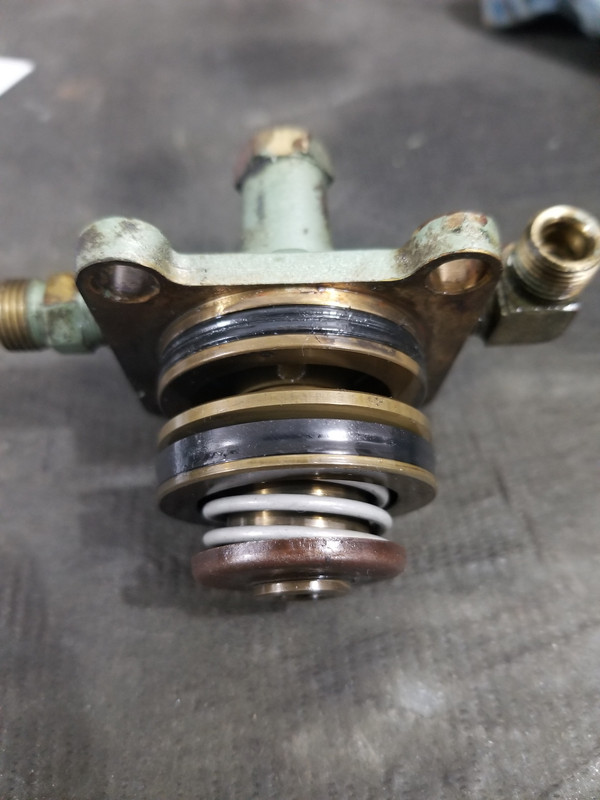

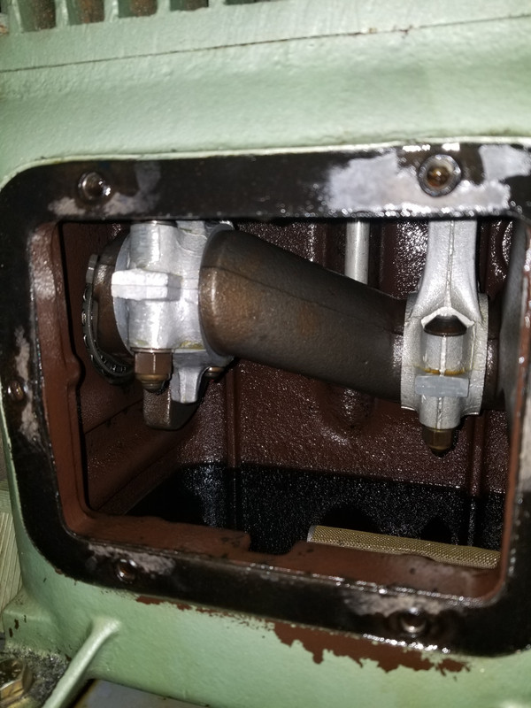

Ok so I decided to swap projects. The car is in the yard, the compressor is apart. One leak is this cover I removed, the other is coming from one of the copper lines to this unloader valve. I'm not sure how that valve is supposed to work, obviously something is supposed to move though. Anything I should look for while I have this big cover off?

No oil should go up the line to the unloaders. That valve you removed works off of oil pressure to open and close. The lines that connect feeds the tank air to the unloaders when the oil pressure is high enough. So if your getting oil in the line going to the unloaders then the seals in that valve needs replaced. Also there is felt and screens down inside the ports where the lines connects to that valve so make sure those are also cleaned while your already there

Nothing really to check for while the cover is off except for maybe cleaning out the sump and checking for play in the rod bearing and end bearings

Thanks Tony for all the help I really appreciate it. I'm going to go ahead and replace the seals in the unloader, and rebuild the towers too so I can stop the leaking back. But I need to order the parts.
Do you know a good place in Canada to order Quincy parts? Theres no one anywhere near me that deals in it. I could order from the US too, but the one place I tried to buy from wanted to charge me $110US for shipping which is absurd.
Edit, I think the unloader is working correctly as there was no oil in the lines themselves, but the O-Ring on top pictured is leaking.

Before I would pull the valves, I'd go to a hydraulic shop and get a pair of replacement x-rings for the unloader valve and try it out. Remember, it is a hydraulic valve, so it is going to react instantly to any pressure drop due to a leak, which sounds like your problem exactly. Once you take the valves out you are creating another pile of work for yourself that may be completely unnecessary. I second increasing the oil pressure, although i have seen 325s running happily for years with 7psi

If your interstage safety valve is not popping, your valves are likely just fine. You can screw a 100 psi gauge in there while its running and see if there is a good steady pressure in the interstage, around 30-40 psi if I remember correctly, and without the needle jumping around erratically. If the pressure is very low, you have low pressure cylinder valve problems, if it is at output pressure, you have high pressure cylinder valve problems.

Thanks, Ill see if I can get some new "X" rings. IT does sound like the exact problem. It will run great at startup, and then start unloading around 100psi, and then suddenly it starts again. It might just loose a bit of pressure and then heat up and expand. It doesn't help my shop is around freezing temperatures right now.

Solberg filters are good quality, but put something on there that you can readily get filter elements for. If there is a compressor shop nearby they probably have something on the shelf. Its just a NPT port, so the possibilities are vast.
I called them x-rings, but the proper name is quad rings. I just get them confused with the x rings in a motorcycle chain sometimes.
The leaky seals may be contributing to the low oil pressure as well. One problem may be exacerbating the other.
