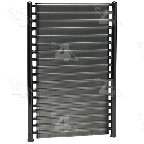

This is the size cooler you should have with maximum output, but they are expensive, you need a 1" fitting cooler to avoid friction loss.....
A Hayden 1290 is the next size down, 1" fittings......
Hayden coolers brochure..,..,
Avoid aluminum tube coolers, you need 350° F temp rating, 300 psi pressure rating.
Any after cooler in a humid atmosphere will produce a lot of water, particularly in the heat of the summer, plumb accordingly.
