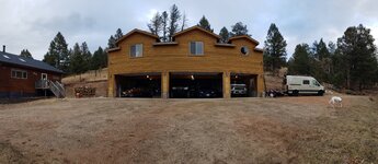

Looking for some insight as I plan out my detached garage finish.
The bottom/garage is 5 car and about 1350 SF with a concrete floor. Eventually I want to install freeflow tiles, but the main focus is to finish out the top living portion. I'm doing the insulation this week then drywall and paint in the next month or so. My question is what will be the best RaceDeck tile on the plywood subfloor? I'm leaning towards the regular diamond but concerned about thermal expansion. This room will go from 0-85 F, but should average about 50-75 F. I will have dirt bikes on the upper level and perform minimal maintenance. Most of the maintenance and dirty jobs will be down on garage level.
Thoughts on tile type for this condition? And should I plan on landscaping fabric for an underlayment either way?
Pics always help!!
Full shot of the detached garage

There is access on the south side with the sidehill cut and a mandoor. Pic below!
The windows do face west so the room will heat up in the afternoon. They aren't big windows so I don't think there will be too much direct sunlight, but blinds will likely be installed before summer time to help.
I will have clearance around the perimeter, but there will be heavy objects on the tiles that will limit movement. (pool table, tool boxes, work bench, cabinets, etc.)
