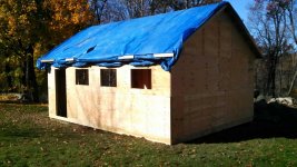

Around two weeks ago, I kicked off the build of my pole barn garage. Due to zoning, the size of my property and grade issues, I was limited as to how large I could go. It’s 18’x24’, with a 9’6” ceiling and some loft storage space….I was limited to a max structure height of 15’. Anyway, the size is not going to be a real issue for me. For the last 10+ years, I’ve been wrenching on my project cars in an 11’x21’ space...one bay in a detached 2-car garage at my sister in-laws house. So she’s selling her house, so I needed to find a new home for my in progress Corvette resto and I decided it was time to build a garage at my house.
So here we go.

Roof on and windows and side entry door in.
